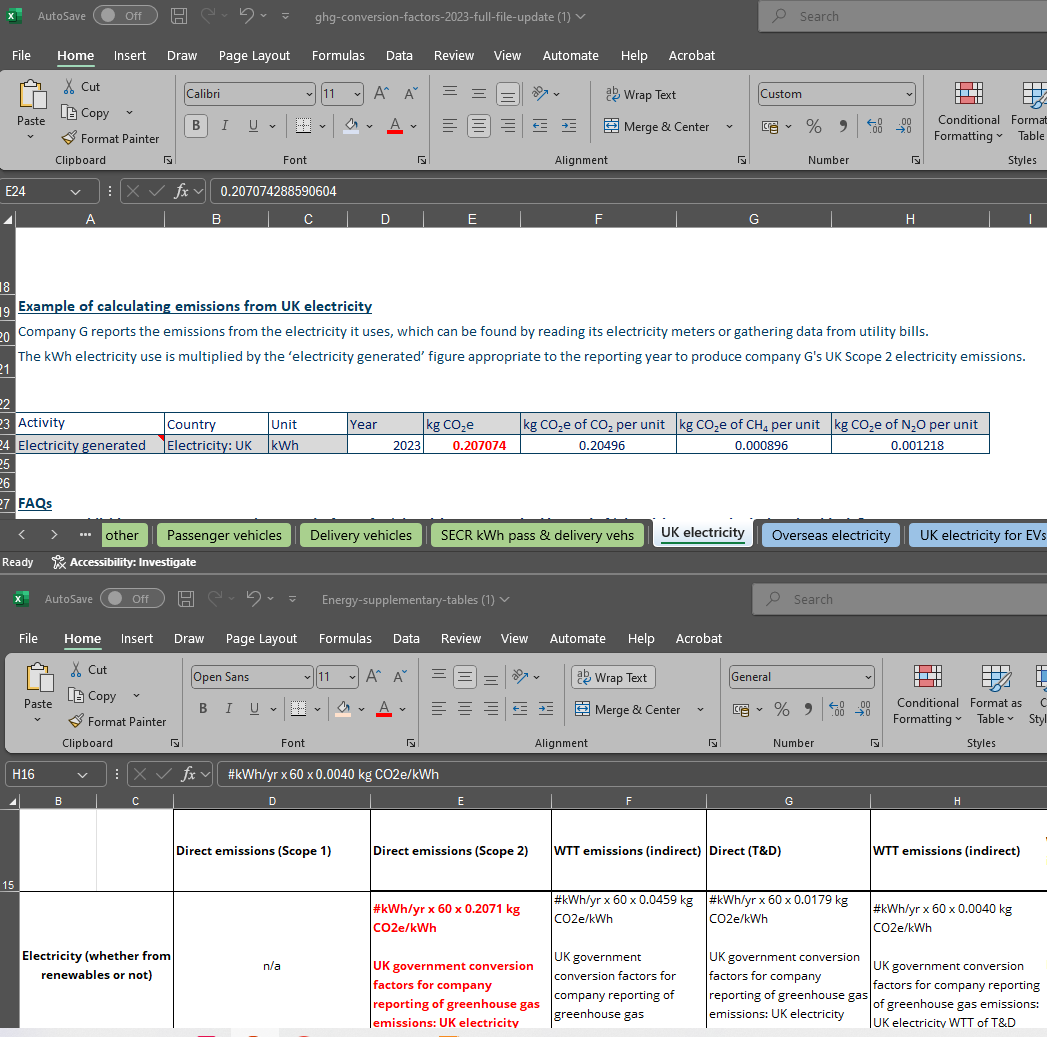

I am working on for an assessment in RICS 2nd edition tool. While entering input for electricity consumption, the available entry is ‘Electricity, UK 2023, based on energy supplementary table of Whole life carbon assessment RICS, 2nd edition’ with ‘0.3 kg CO2e / kWh’ carbon factor
However, on checking the source i.e Energy supplementary table and 2023 electricity carbon factor from UK Government GHG Conversion Factors, there is a different carbon factor of 0.207kgco2e/kwh. Please see the attached screenshot. Can you help me understand why is there a difference or where I am going wrong?
Hi Hiranmoy,
Good question. The 0.207 kg CO2e / kWh isn’t the total picture; to calculate the actual emissions we also need to consider the WTT and indirect emissions. I’d recommend to check the following link under the section ‘Q: Which set of carbon factors are used for B6 calculations?’
Adding up the carbon factors (0.2071 + 0.0459 + 0.0179 + 0.0040 + 0.020 + 0.0004), gives 0.2953 kgCO2e/kWh
The data point currently in the tool reflects this as rounded up to 0.3 kgCO2e/kWh.
Let me know if you have any further questions.
Thank you for the clarification. It is helpful, Steven!
Do you think we should capture 'Direct emissions (Scope 2) ’ from 2025 data ( which is 0.177 kg CO2e/kwh) instead of 2023 data ( 0.2071 kg CO2e/kwh) to stay updated?
If a full range of emissions exists for the 2025 profile (so including Scope 2, also WTT and T&D) then we could add a 2025 option. For many schemes, we update the required annual profile yearly; however, it depends on what the scheme specifies as required. I’ll look into this first thing tomorrow.
