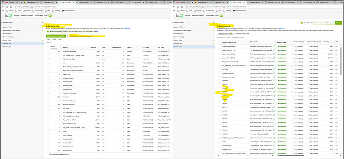

Hi Team,
Why does the material list and grouping changes by a lot between step 6 Combine Data and step 7 Data mapping?
Is there something I need to tweak in my model regarding this?

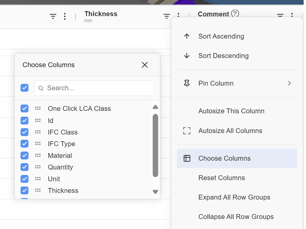

You can display additional columns to be displayed in the IFC viewer:

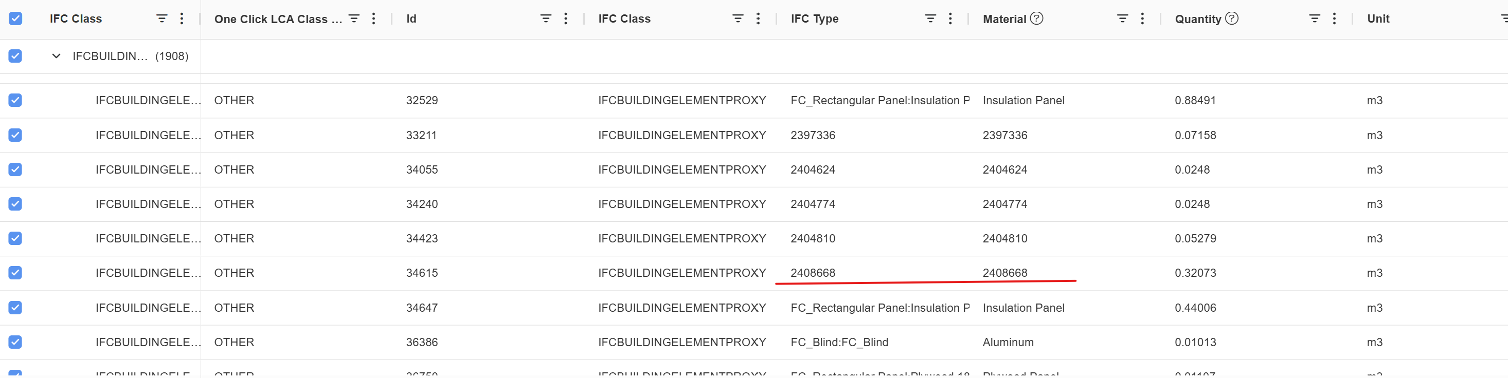

When you do that, you will see that for a number of elements the ‘IFC type’ and ‘Material’ only contain numerical values. If it cannot take the material names from another parameter, by default it takes those.
I would recommend assigning those material names in the IFC model (or exporting additional info that helps you with mapping to the ‘comment’ field).
