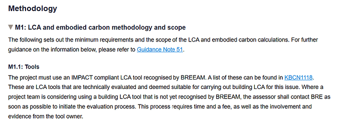

New guidelines: Page 147 of BREEAM NC RESI (HQM) -
Key one is filling BREEAM embodied carbon reporting tool with all modules except B6,B7, D. However we dont have an option to input Construction site operation (A5) in the impact tool. Can you help me on this?

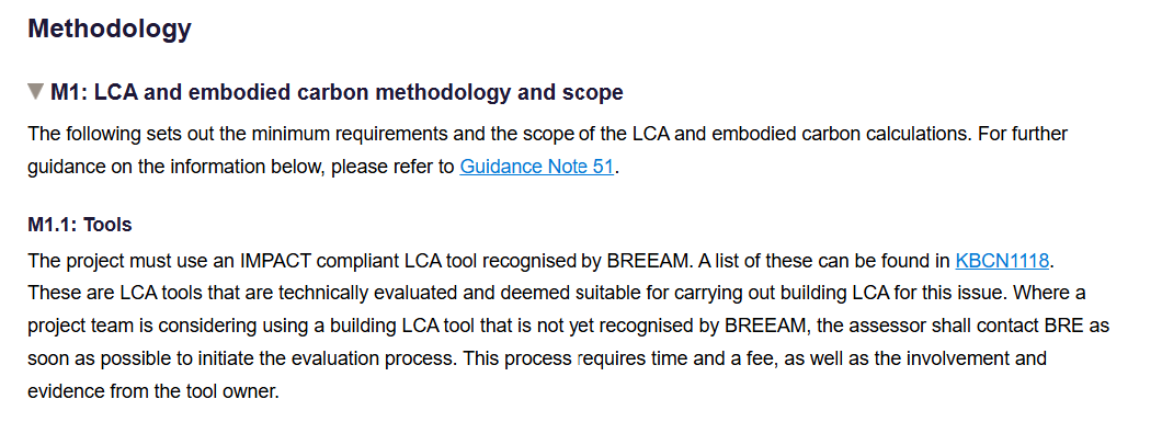

I just checked the BETA version of the manual (v7), it does say IMPACT tool is must.
The current manual is temporary; the IMPACT database requirement will be updated when the final guide is released. We’re in almost daily contact with the BRE, and I really appreciate their proactive engagement with those who understand how the tools and schemes function in practice. It’s great to see our feedback, genuinely being incorporated.
