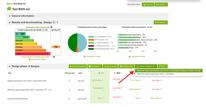

Hello Shalani,
Carbon Designer 3D does not have any pre-defined life cycle modules. The life cycle modules are predetermined by the tool you have selected when creating the Carbon Designer 3D design.
So if you choose to start a design using the RICS second edition tool, the scope in Carbon Designer 3D will be the one from the RICS 2nd edition tool.
