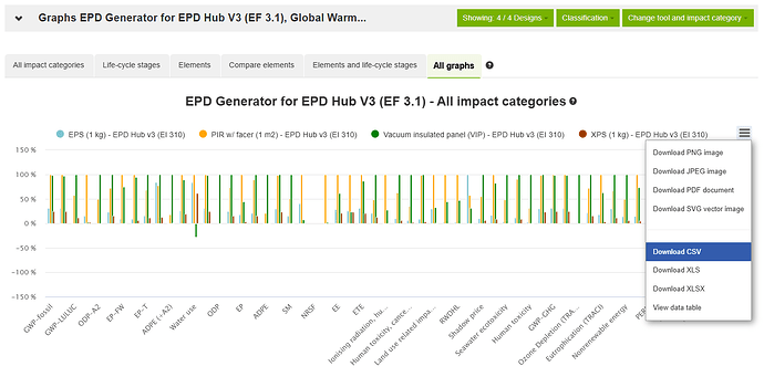

Depending on what kind of results you want to see (specific impact indicators or life-cycle stages), you can download the data from the graphs on your project page:
You can do this for all available graphs, and can customise the graphs for specific impacts or stages as needed.

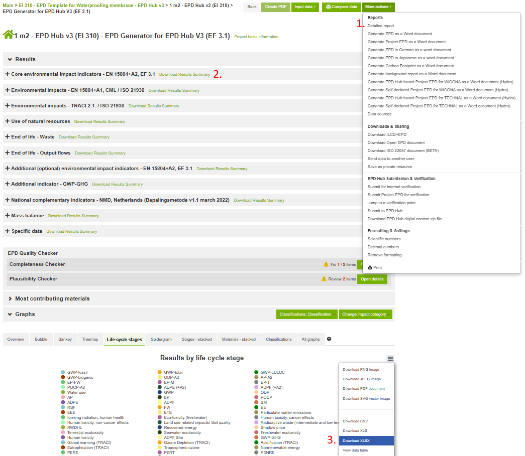

Would it be possible for me to get the all-impact categories in stage level as per A1-D module, for all the designs created?
And based on the sample that you showed, the extracted data was not as robust as I am expecting - it only shows me the x-axis value and y-axis value of the graph and manual calculation is still needed to get the data (in kg CO2 eq). Will there be any ways I can get the kg CO2 eq extracted as a whole for all the impact categories that I am unaware?

The other graphs on the project page are all per a single impact category, with the default being GWP-fossil.
For all impact categories and all life-cycle stages, you would need to get this from the individual design’s results page, either from 1. the detailed report, 2. results summary (for specific results table), or 3. life-cycle stages graph.
I recommend option 3 for your use case.
I will submit a request to our Product Development Team about the possibility to download absolute values for the results for all designs in a project - great improvement suggestion!
